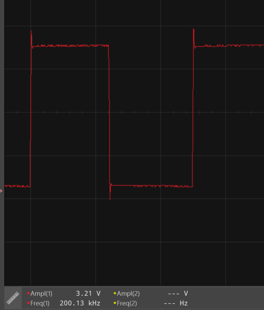

With a period of 539, I get 200Khz as expected:

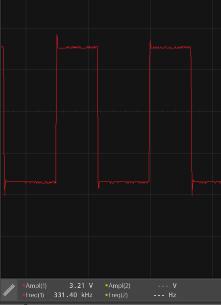

With a peroid of 215, I get around 330 kHz instead of the expected 500Khz.

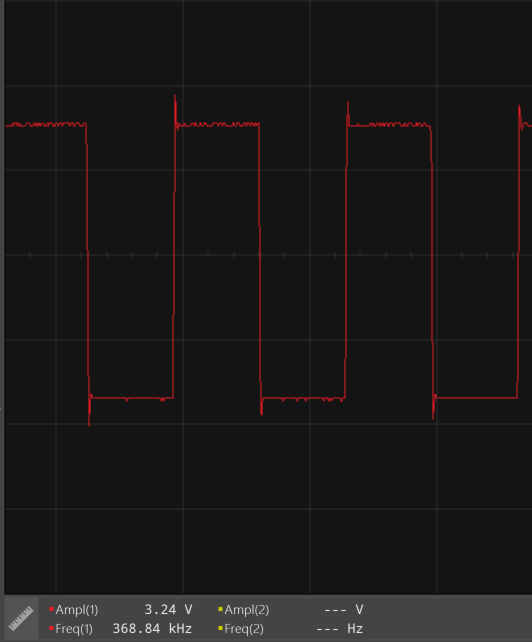

With a period of 108, I get a frequency of around 369Khz:
