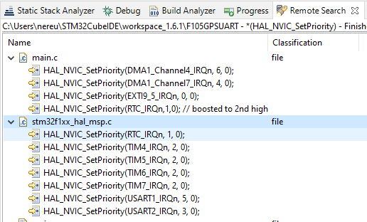

I could locate the HAL_NVIC_SetPriority() calls for DMA and EXT1 Interrupts in main.c as shown below.

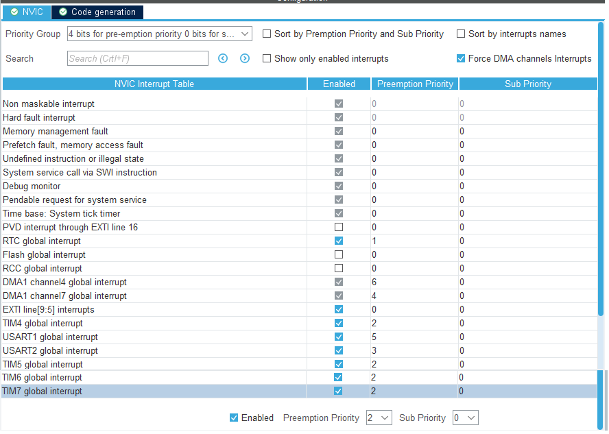

I could not find the HAL_NVIC_SetPriority() calls for RTC, USART & Timers - TIM4, TIM5, TIM6, TIM7. Where is the interrupt priority for these peripherals set in the code by CubeMX?
The CubeMX configuration is as follows :

You can use Search -> File... to find all instances of HAL_NVIC_SetPriority to see if/where they exist.
It's possible they aren't set up at all if the peripheral isn't enabled.
2022-03-02 9:42 PM
Thanks, the HAL_NVIC_SetPriority() calls are added to the stm32f1xx_hal_msp.c file in the HAL_<Peripheral>_MspInit() functions
