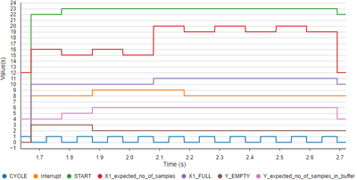

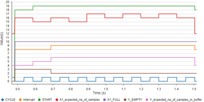

I'm also trying to figure out how FMAC works. My idea was to replicate an example of FIR filter operation in STM32G4 Reference Manual shown on p.496. I've configured FMAC to generate WIEN Interrupt. When X1 is running full the interrupt should be disabled. I run read-write sequence is before while(1) loop. After each w/r cycle i read FMAC register values in the arrays. I then output values in the while(1) loop with delay an read them via STMCubeMonitor, because I'm not able to read them in real time (STMCubeMonitor max. sample rate is 1ms). Unfortunately I'm not able to get X1_FULL with 6 Samples written into buffer (X1_BUF_SIZE = 6). It seems FMAC is running faster than my code. I assume the calculation is done immediately if X1 has enough samples to perform convolution and Y is not full. I then started to icrease number of writes of X1. I was able to get X1_FULL howewer, according to my calculation there shold be 8 samples in the X1 buffer - mor then its configured size of 6. I provided screenshots of 1st and 2nd attempt with increased number of writes. The values are ofsetted for readability in STMCubeMonitor - I hope it's more or less unerstandable. If you're interested,here is my sourcecode: https://github.com/evgenmlnk/teamproject_stm32/tree/main/FMAC/nucleo-g474re-fmac-registers-test1

I never used any of the interrupt stuff and only used it for speeding up weighted sum computations in a one-shot mode rather than ongoing FIR computations.
