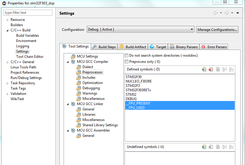

Can you check the configuration of your project this way:
Into
System Workbench Project \ Properties \ C/C++ Build \ Settings \ Tool Settings \ Preprocessor
Check if __FPU_PRESENT and __FPU_USED symbols are defined

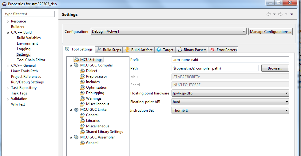

And then into MCU Settings Floating Point ABI is hard
Best regards

I have both those symbols defined in the preprocessor.

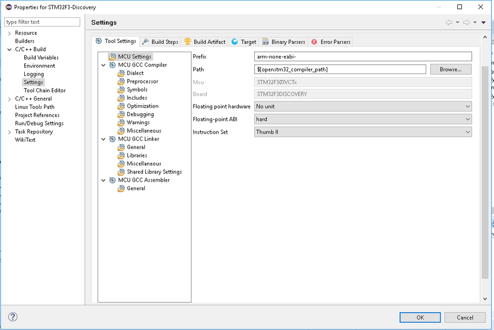

But my problem could be this. I cannot select anything under Float Point Hardware. I have only No unit listed.
Could this be the problem?
