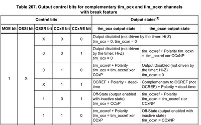

2025-02-10 7:30 PM
> i found out, that the output is floating, when it is not activated to output the PWM signal of timer 8.
> Is there a way to have the output not floating?
If you want a specified state when the chip is in reset, an external pullup is needed. Otherwise, you can configure the pin with an internal pullup which gets activated when the program runs.
You can see the output states of pins when MOE=1 in this table. Choose one in which they're not floating.
