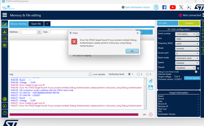

The messages are enable debug authentication or error connecting.
In my test setup with the chip clamp, it is very inconsistent. Sometimes it starts on a power cycle, some times it does not. Right when I plug the stlink into my computer, it starts toggling the led (most of the time). But if i use an external power supply, it works very inconsistently. Also, sometimes I get the debug authentication error on my test setup, but i just unplug the stlink and try again and it works.

@at3 wrote:The messages are enable debug authentication or error connecting.
It's better to copy/paste the actual messages, and/or give a screenshot, rather than try to paraphrase or summarise.

You've configured the CubeProgrammer to connect under Hardware reset, but there is no NRST in your debug header.
Add NRST to your debug connection, and try again ...

I tried that earlier, no luck with that. Also, with those same settings, I was able to connect to the chip in the clamp (without the reset) using only 3.3V, GND, SWDIO, SWCLK
