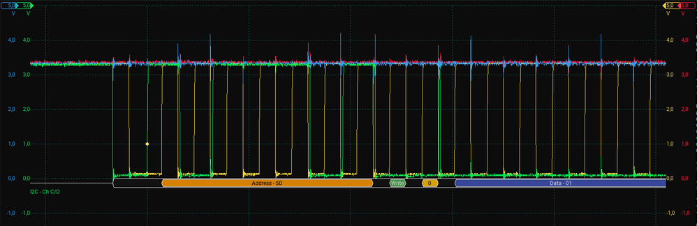

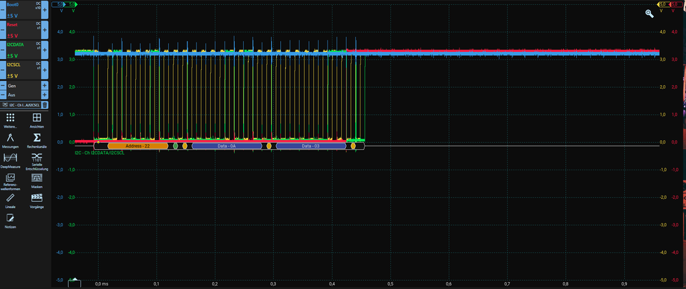

even non-stretch commands (non-stretch memory erase command) drop the SCL to zero without recovering. SCL stays low, when master is disconnected. Here are 2 pictures of the signals captured with an oscilloscope. First picture shows an successful erase (workaround), second picture shows the SCL failure of non-stretch memory erase command.
blue -> boot0 pin, red -> reset pin , yellow -> I2C SCL, green -> I2C SDA
erase success (workaround)
erase fail
2023-12-18 8:22 AM
It is definitely an error case caused by the microcontroller. As soon as SCL is broken by reading/writing at address 0x5d and the master is removed, it does not recover. The Clock only recovers after a power cycle. Even if a read command (i2cget) is sent to bootloader address 0x5d (after reset + boot0 pin to high), the clock collapses as shown in the oscilloscope image.

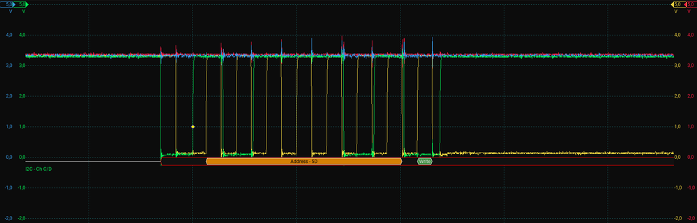

The clock stretching begins even with no-stretch commands. The erase fail.png attached is captured after sending the first two bytes. I use i2ctransfer command to send these two bytes to address 0x5d as follows:
i2ctransfer 1 w2@0x5d 0x45 0xBA
As I said, the clock is not recovering unless a Power Cycle is done. If clock stretching is enabled, shouldn't it recover at some point?

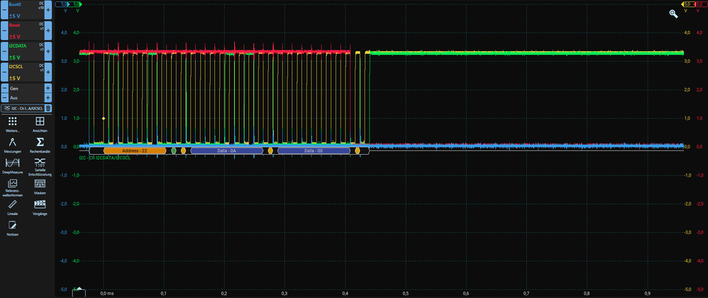

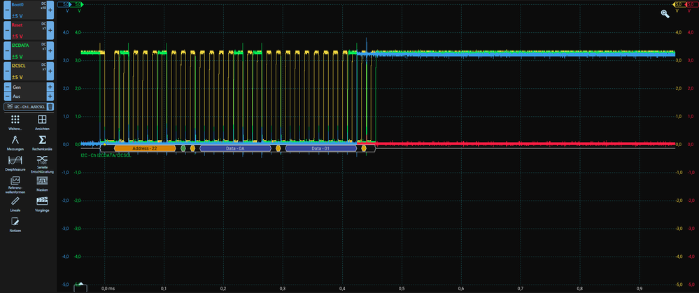

The bootloader is enabled by pulling mcu reset low, putting boot0 on high, then releasing reset pin. This is all done by an GPIO-Extender, which is also addressed by I2C. See pictures underneath.
enable mcu reset
enable boot0
release mcu reset
