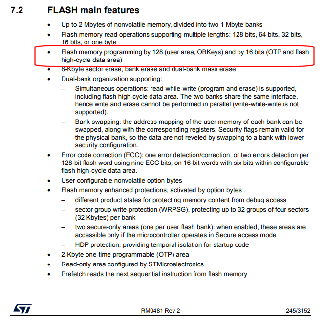

@Alban wrote:On H5 it looks like it's possible to write flash only with 128 bits sections. iate!
Indeed - except the OTP and high-cycle data area:
2024-12-03 1:51 AM
That's true!
But I'm writting between 0x8000000 and 0x80F0000. And for what I've seen, OTP memory is somewhere at 0x08FFF800 (Or even further).
Sorry for the shortcut!
