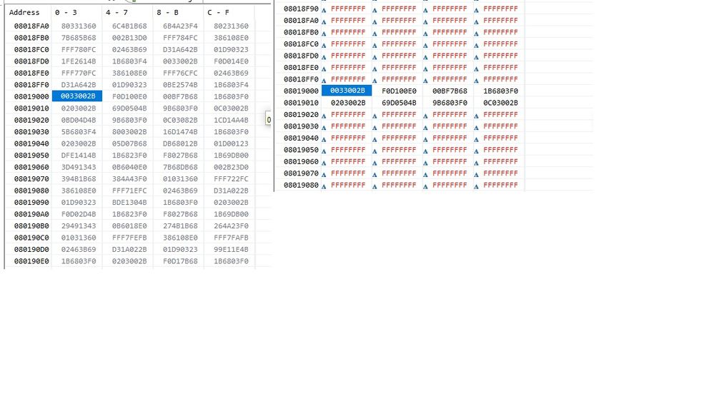

Thank STM32 user .. I am running the following code... It should erase everything starting from sector 3
int16_t FlashEraseApp(void)
HAL_StatusTypeDef res;
FLASH_EraseInitTypeDef erase_init;
uint32_t page_error;
/*data has to be in hex format*/
uint64_t data_validity =0x00;
char* demo="ciao";
uint32_t address = *(__IO uint32_t*) (ADDRESS_TEST);
erase_init.TypeErase = FLASH_TYPEERASE_SECTORS;
erase_init.Sector = 3;
erase_init.NbSectors = 4;
erase_init.VoltageRange = FLASH_VOLTAGE_RANGE_3;
HAL_FLASH_Unlock();
HAL_FLASH_Program(FLASH_TYPEPROGRAM_WORD, (uint32_t)&_app_validity, data_validity);
//HAL_FLASH_Program(FLASH_TYPEPROGRAM_WORD, ADDRESS_TEST, *(uint32_t*)demo);
// cancellazione di tutti i settori dell'app
__HAL_FLASH_CLEAR_FLAG(FLASH_FLAG_EOP | FLASH_FLAG_OPERR | FLASH_FLAG_WRPERR | FLASH_FLAG_PGAERR | FLASH_FLAG_PGPERR );
res = HAL_FLASHEx_Erase(&erase_init, &page_error);
//FLASH_Erase_Sector(FLASH_SECTOR_3, VOLTAGE_RANGE_3);
HAL_FLASH_Lock();
if (res == HAL_OK) {
return 0;
return -1;
}But when I read the memory flash I discover that some flash addresses are not deleted... can you help me to understand this ? Thanks a lot... Regards
2021-07-18 1:47 PM
The debugger shows what the CPU sees. The FLASH memory is actually deleted, but at the address 0x08019000 you seeing a 32 bytes (a single cache line) of data from D-cache.
For a typical data usage the solution is to call SCB_InvalidateDCache_by_Addr() on the erased memory after erase operation. If you are flashing and executing a code without doing a system reset, you will have to also use SCB_InvalidateICache_by_Addr(). But for bootloaders the performance is not critical and the safest and simplest option is to not turn on cache memories at all!
