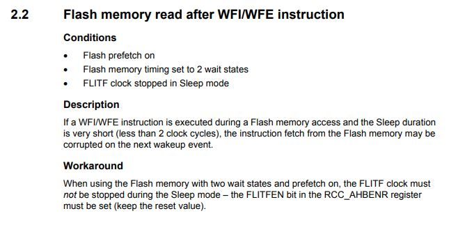

Make sure to use latest release of STM32CubeF1 MCU package, and have a look to the errata sheet related to the STM32F103 devices, to check if you have the same conditions as described:
Please keep me informed about your progress on this.
Imen
