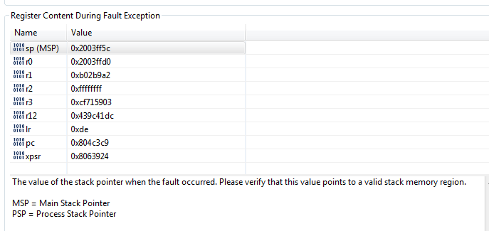

{ SaveFlashApplication(size); appStack = (uint32_t) *((__IO uint32_t*)APPLICATON_ADDRESS); appEntry = (pFunction) *(__IO uint32_t*)(APPLICATON_ADDRESS + 4); SCB->VTOR = APPLICATON_ADDRESS; __set_MSP(appStack); appEntry(); while(1); break; }The code successfully arrives at the app location and begins to run the startup code. However, something causes a hard fault in/around the subsequent startup (_stm32f765xx.s) code bl __libc_init_array. I have stepped through the code and it appears that the processor is skipping over this array initialization. The TrueStudio Fault Analyzer says:
This seems to have something to do with data alignment, but I have no clue where. I have seen other threads that talk about DFU data alignment issues. But I am not using DFU. I am simply programming the image directly to flash. The size of the binary image that gets flashed is 0x2B1EF, so I pass the size value of 0x2B1F0 to the flasher in the bootloader hoping that it may avoid some sort of data alignment/boundary issue with the flasher. to no avail.
