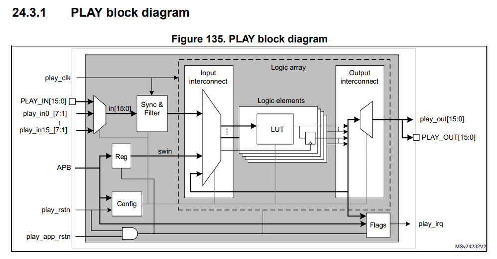

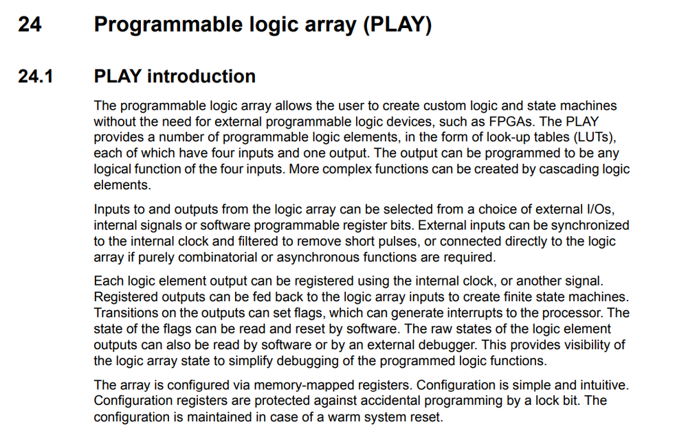

Getting back to this old thread and to announce that PLAY (Programmable logic array) peripheral wasintroduced in the new STM32H5 series (H5F/H5E).
You can refer to the reference manual RM0517 / section 24 Programmable logic array (PLAY) for more details.
Enjoy the new feature :).

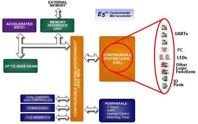

I remember the Triscend devices:
https://antronics.co.uk/portfolio/csoc/
The tooling was, indeed, key.
And it did take a lot of support - someone had to help them: https://developer.arm.com/documentation/kan159/latest/

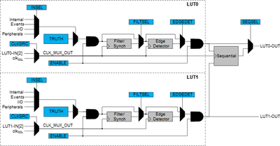

Microchip have their CCL (Configurable Custom Logic) peripheral in some AVRs:
