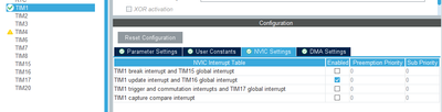

I see one differnce between the two projects:
TIM1 NVIC is enabled with premption prio = 0 and sub prio = 0 for the working project. I don't think its has relation with your issue but try to enable it in the non working project.

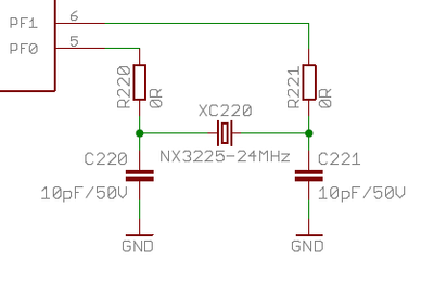

In your schematics, you are using STM32G431 but in the CubeMx you are using STM32G491!
Are the attached ioc file the files you have used for the two CAN projects (working and non-working)?

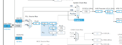

Also, please use the Crystal you have on the board for the CAN communication:
instead of the internal HSI (not recommended for CAN).
This is the new config:

The assembled controller is the correct one, this is only a deviation in the circuit diagram. The 2 projects were quickly nailed together by us, but I have checked your findings. No change.
