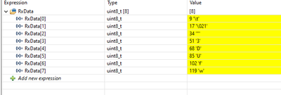

Just tested the project on a compatible MCU (on STM32U5G9 DK board) I've just adapted the value of crystal 25MHz -> 16MHz and it's working perfectly. The Rx callback is raising and the data are receiving very well.
This is the Live Expression and as you can see the value is updating. Just added the incrementation of the first data TxData[0]:
See attached project. So need to check again from your side.
Hope I answered your question.

Thank you for attaching a working example. I tried running the same project (only changed the clock source as I have a 32Mhz osc instead) but it is not working.
Given that this is testing internal loopback, is it safe for me to assume the specific MCU I have is just faulty? Not sure how else to proceed at this point.
