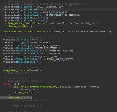

2024-09-16 5:07 AM
I have made the changes you have pointed out, including a screenshot as I think it would be easier for you to access, given that I have not changed anything else. I am still not getting any data in my RXData buffer though.
I appreciate your patience in assisting me solve my issues,
Thank you!
