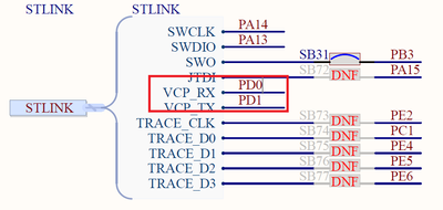

You can't use CAN pins that are already connected to something to the HW. They need to be free. In your case for example and according to the schematics: PD0 and PD1 are used by the VCP (Virtual Comport). PD0 and PD1 need to be free.
Need also to set the IO speed to at least High speed.

However, when I turn on FDCAN1 the default pins selected are PB8 and PD1. And no conflicts are detected by the .ioc file, that's why I didnt check it out. I changed them to PB8 and PB9 but those seem to be connected to camera connector (I dont have camera connected). The issue presists. TxBuffer is getting filled while RxBuffer doesnt recieve anything (interrupt not triggering, messages not being sent).
EDIT: I have also unsoldered R52 and R56 so PD0 and PD1 are not connected to VCP anymore, issue still presists.
EDIT_2: I have realized that PD0 and PD1 are arduino connector pin names and are not actually connected to FDCAN but to UART. Anyhow, even now that I use osciloscope on the correct pins still nothing to meassure, since that didn't fix loopback.
