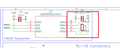

+ Could you please explain this hardware?:
Why are you using a 1.5k on CAN_H and CAN_L lines? and how are you connecting these two lines externally?

So question still: what did you connect to the CAN bus apart that node (STM32G474+ADM3050)? and why is there a 1.5k ohm connected on the CAN_H and CAN_L on the tranceiver pins? it should be 120 ohm.
Also only two 120ohm are termination the bus.

And what are the two schematics you've attached? the two CAN nodes that are connected on the bus?
What is the relation of the firmware you've attached from the beginning to these boards? one project for each board? If yes, you need to tell which project corresponds to which board.
Please be accurate in the information you provide to avoid unnecessary ping pongs.

These 2 schematics are the PCBs I am communicating between.
FDCAN_receive.zip -----------> Braking VCU 2024-2025
FDCAN_F.zip (transmit) -------------> LVCU 2024-2025
