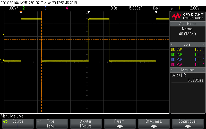

I measure the time between TESTA11_OFF-TESTA11_ON.

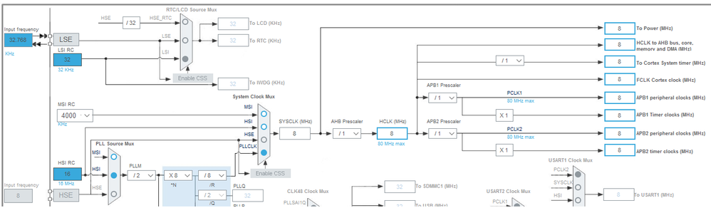

For the 8MHz configuration:
CubeMx sets : LL_FLASH_SetLatency(LL_FLASH_LATENCY_0);
The processing time is 6.28ms

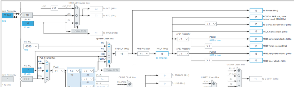

I change the configuration to 16MHz by CubeMx:
The processing time is always 6.28ms.
Even if I change the clock to 80MHz (latency set to 4 this time), the processing time is always 6.28ms.
This time is always the same whatever the clock frequency used. How could it be possible?
Even with to different clock frequencies (8 and 16 MHz) and the same flash latency (0), the processing time is the same.
How could I correct that?
