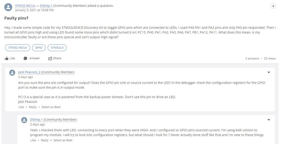

Hey, I made some simple code for my STM32L053C8 Discovery kit to toggle GPIO pins which are connected to LEDs. I used PA0 PA1 and PA2 pins and only PA0 pin responded. Then I turned all GPIO pins high and using LED found some more pins which didn't turned it on: PC13, PH0, PA1, PA2, PA3, PA6, PA7, PB1, PA12, PA11. What does this mean, is my microcontroller faulty or are these pins special and can't output High signal?

Probably means they are connected to other things on the board. Check how they are committed, if there are solder bridges (SB links) to the headers.
https://www.st.com/en/evaluation-tools/32l0538discovery.html

I checked datasheet and it turns out that most of these pins are for linear touch sensor, some are for IDD Measurement. So is there any way to use these pins on my board for GPIO function?
