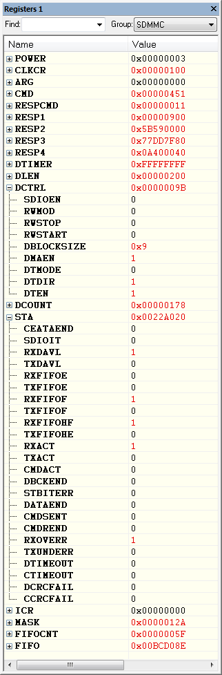

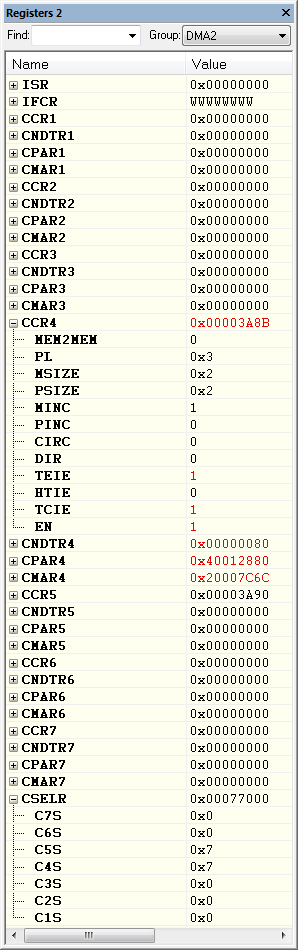

From the two pictures showing the SDMMC and DMA2 registers at the time the SDMMC controller interrupts after the transfer from the SD card, can anyone see a potential problem?
Supplementary information to the pictures:
For the SDMMC controller:
* In the DCTRL register DMAEN is set to activate the DMA transfere.
* It can be seen that we have a FIFO overrun status due to the DMA not reading the FIFO as expected.
On the DMA side it can be seen that the DMA channel that must be used (DMA2-ch4) is setup with:
* Mapping in the CSELR for the SDMMC controller.
* Setup for the transfere in CCR4.
* Count, source and destination as expected.
In the CCR4 register of the DMA, clearing the EN bit, setting MEM2MEM bit and then again setting EN bit, immediately triggers a complete transfere, interrupting as expected after counting down the CNDTR4 register, so the DMA seems to have internal clocking as expected.

Hey,
It's a bit to late but maybe it will help some people that struggling at same problem. There is little issue with the DMA controller on L431. The L431 can use only a single DMA Channel at a time. So you have to use the SDMMC1 for DMA Request and change the direction for every read and write action also before BSP_SD_ReadBlocks_DMA() and BSP_SD_WriteBlocks_DMA().
