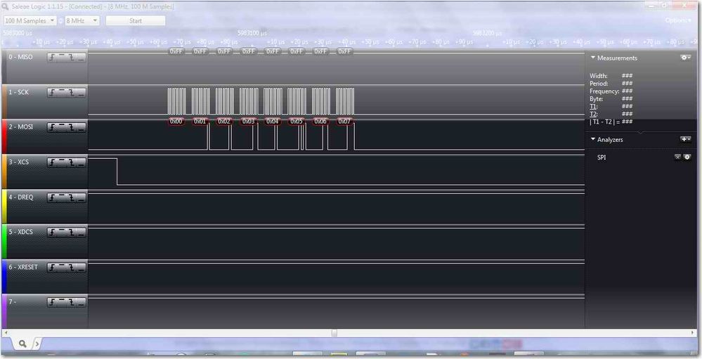

SPI2 test is working OK !
as I can see on logic analyzer Code :
HAL_GPIO_WritePin(GPIOB, GPIO_PIN_10 , 1 );
HAL_Delay(100);
HAL_GPIO_WritePin(GPIOB, GPIO_PIN_10 , 0 );
uint8_t data1[8] = { 0x00,0x01,0x02,0x03,0x04,0x05,0x06,0x07 };
HAL_SPI_Transmit(&hspi2,data1,8,1000);
