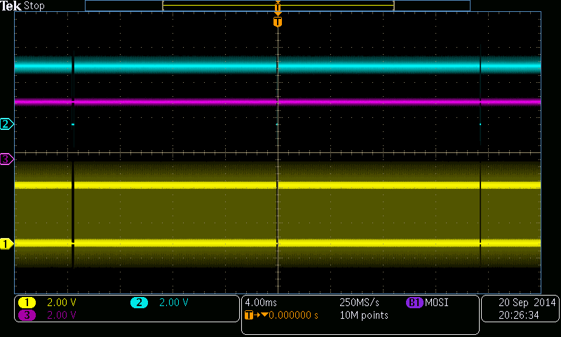

Just tested how fast FT2232D SPI is, well, in read workd it gives 5,27Mbps, while ftdi states that it can go up to 30Mbps, i have no idea how they can say that, if at maximum spi clock frequency gap between two burst of 1024 chars is very small.
(100us)2014-09-22 12:17 AM
No wonder that you cannot go faster than 5.27Mbps. The FT2232D DS says that using MPSSE (I assume this is the way SPI is configured), the maximum sustainable rate is 5.6Mbps. So you achievement is pretty good.
Well you nearly hit the max bandwidth of your device. I don't known where you read about 30Mbps, but it can't be a sutainable rate as FT2232D is a full-speed device (12Mbps on USB). Maybe 30Mbps is the max SPI clock for a transfer with a limited amount of data, not very useful in your case.2014-09-22 5:25 AM
