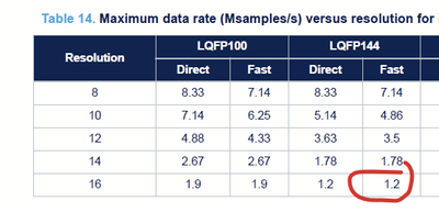

im using STM32H743ZI2 Evaluation board set to 32Mhz
the ADC is 16 bits and running on "fast channel" so therefore should be 1.2Mhz according to AN5354

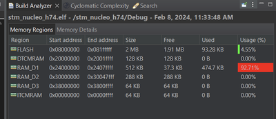

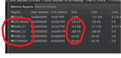

* RAM is limited and even though im supposed to have 1MB to my disposal i'm only managing to build the code for an array of about 220k half words
uint16_t adc_buffer[220000]
* now even when im using this "small" buffer when using DMA with it im only filling the first 65535 values.
You have slightly more than 1 MB available, but it's split among different non-contiguous memories. Because of this, you can't have a single buffer of 1 MB.
External memory can be added if you need more.

also i just now realized that i wasn't able to use the ADC at it's full sampling speed because of the "sampling time" parameter which was set to around 800 (followed an example online)
i changed it to 1.5 cycles now and now i am sampling at 2MSPS, which is also kind of odd considering i was supposed to be limited to 1.2MSPS?
To achieve the stated accuracy in the datasheet, you should limit sampling to the rates given in that table. Nothing is preventing you from converting faster, but the accuracy will be limited. At that point you're better off using a lower resolution.
