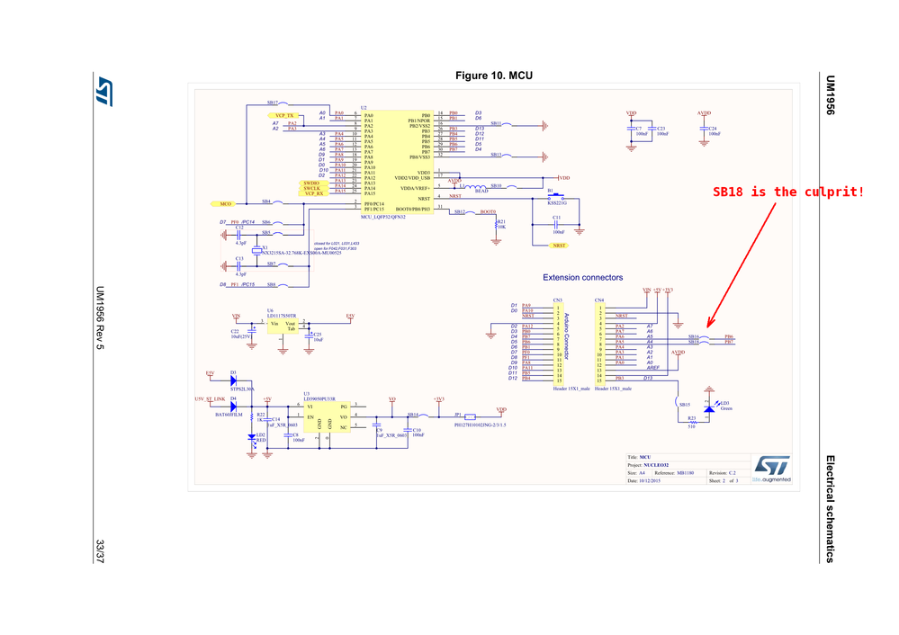

EDIT : Here are the waveforms on scope. When disconnected from slave, the waveforms are perfect. However when I connect the master to slave, there is some noise and the SCL line has a amplitude of 900mV.
2020-06-22 11:54 AM
> I checked user manual to see if PA5 was connected to something and don't really see anything.
Hummm...
In a minimal program, try only setting PA5 as GPIO Input with pulldown, and measure.
2020-06-22 12:26 PM
No, I use barebone gdb which is not the easiest thing to use; but Keil should be usable for it.
2020-06-22 12:37 PM
> My slave in this program is a Nucleo L432KC.
Which user manual did you check?
