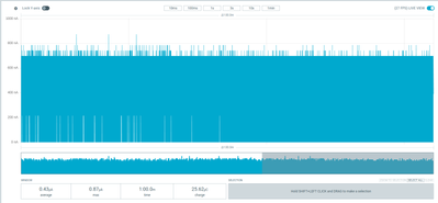

The current measurements are shown below. One thing to notice is that some peripheral seems to be waking up every 2 minutes. I ruled out the system tick and the watchdog. The debugger is not attached to the connector when collecting these measurements.
Below are the same measurements taken after changing the code as:
- HAL_PWR_EnterSTOPMode(PWR_LOWPOWERREGULATOR_ON, PWR_STOPENTRY_WFE);
+ HAL_PWR_EnterSTANDBYMode();
In standby mode the average current drops to 0.42 uA and there are no periodic wake ups.
I have looked at this great post on low power modes and I think I'm addressing all the potential errors it describes.
Can anyone suggest what could be the cause for the excess consumption? Or whether this periodic wake up is normal/expected?

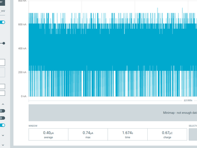

Hi @Sarra.S ,
Thanks for following up. I had already tried essentially the same thing:
This time, however, instead of modifying the STOP example, I did as you suggest and run the STANDBY example: `STM32Cube_FW_L0_V1.12.3/Projects/NUCLEO-L053R8/Examples/PWR/PWR_STANDBY`. The current draw is the same as my previous experiment, ~0.40 uA
It does not look like a PCB issue, given this result, and the fact that the PCB is bare except for the MCU.
Do you have any other suggestions?
Thanks!
Javier
