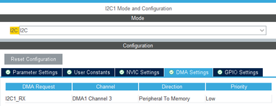

1. STM32F072+STM32CUBEMX+FREERTOS+I2C1 DMA
2. I2C1 was set for rx DMA
2. I use HAL_I2C_Mem_Read_DMA() for external device memory reading and it retured HAL_OK,but no data written to DMA buffer , DMA1_Channel2_3_IRQHandler for i2c1 DMA was not entered

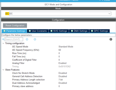

Make sure to enable I2C1 with the right pin & configuration (e.g., PB6 for I2C1_SCL and PB7 for I2C1_SDA).
Enable DMA for both I2C1_RX and I2C1_TX. Enable FreeRTOS with the necessary settings (heap size, task priorities). Ensure that the interrupt handlers for I2C and DMA are properly set up.
Check I2C, clock Speed.

Hi Imen:
Thanks for your reply.
1. i2c can read successfully when not using DMA, so i2c hw and sw configuration is OK on stm32f072
2. i2c dma read also successfully on STM32F105, I can't get the difference of i2c dma usage between stm32f072 and stm32f105
