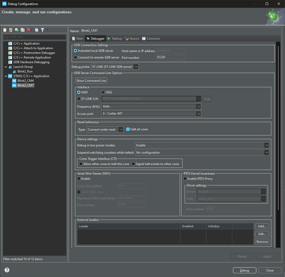

This post on GitHub follows the same debugger setup as AN5361 Section 3 with one exception: in the CM7 configuration, it shows 'Halt all cores' as checked which contradicts AN5361 . Which one is correct or does it matter?
I also implemented this suggestion from that post:
while(__HAL_RCC_GET_FLAG(RCC_FLAG_D2CKRDY) != RESET) { asm("NOP"); }
Of course, all help/suggestions are greatly appreciated!

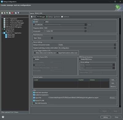

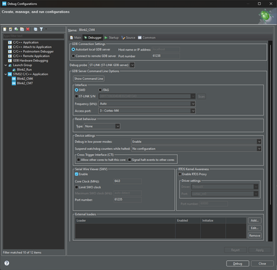

Here are my debugger settings for both cores:
CM7
CM4

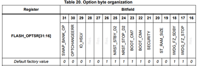

When CM7 is stuck and is waiting for RCC_FLAG_D2CKRDY, it means the D2 domain has not booted properly.
As CM4 is in D2 domain, did you checked the option byte BOOT_CM4 is correctly enabled on the device?
Can you also confirm that NRST_STOP_D2 and NRST_STBY_D2 option byte are enabled?
Here a link for a similar issue if these option byte are not properly enabled.
Dual Core boot up example · Issue #34 · STMicroelectronics/STM32CubeH7 · GitHub

Well the BCM4 flag OB was the culprit. I am finally running both cores!
I have read through the STM32CubeIDE and STM32CubeProgramming manuals and I've never seen anything that explains the Option Bytes. The STM32CubeProgrammer Section 2.4 simply reads "For more details refer to the option bytes section in the programming and reference manuals, available from www.st.com
Which manuals is it referring to?
Does STM have a central location for all of the documentation? I have also perused all of the docs shown on the CubeIDE Information Center and I never saw anything about Option Bytes. Where is the document that explains Option Bytes?
Again, thank you for your help!

Their description is in section 4.4 FLASH option bytes.
As the STM32H747 is dual-core, both the Cortex-M7 and M4 cores are enabled for all devices leaving our factories. This is the default configuration (see RM0399 in Table 20. Option byte organisation) and you would find this on one of our NUCLEO-H745ZI-Q or STM32H747I-Discovery boards:
https://www.st.com/en/evaluation-tools/nucleo-h745zi-q.html
https://www.st.com/en/evaluation-tools/stm32h747i-disco.html
I think that disabling the BOOT_CM4 byte option is done by Arduino? Do their SDK and example use both cores? I don't know?
