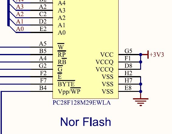

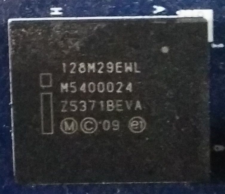

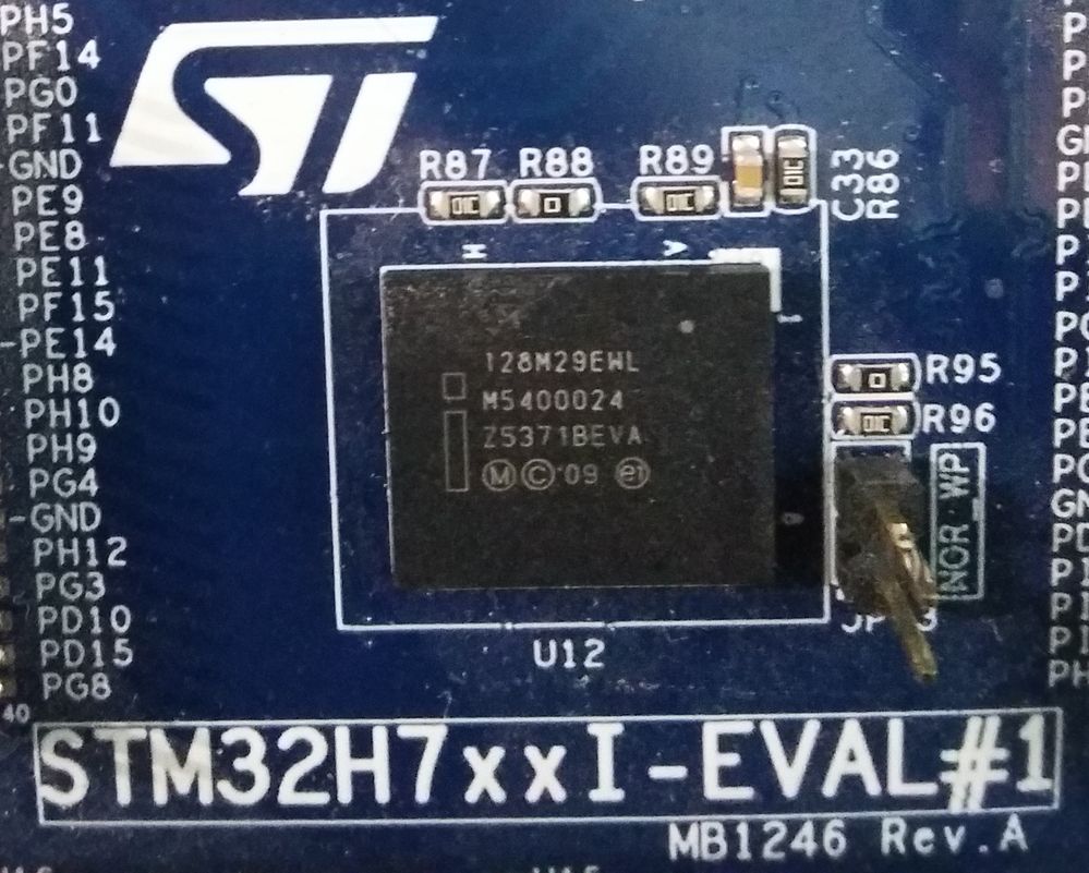

14:31:58:228 : Error: Download verification failedNote that although the readme says to flash ""M29W128GL_STM32H743I-EVAL", in the EVAL guide it shows in schematic PC8F128M29EWLA.
As you can see in the log, the verification failed.
Note that erasing external full chip is successful.
