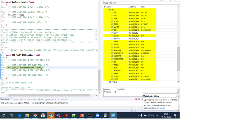

I am facing a strange issue with STM32G0 RTC. As soon as I initialize RTC, it generates an interrupt and it never comes out of the interrupt. Same program was working previously and suddenly it started throwing this kind of issue. I am wondering what really went wrong

Hmmmm.. It was my mistake.. Somehow handling of wakeup interrupt got removed from my code and I didn't notice it.
