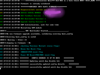

2023-08-19 3:21 AM - edited 2023-08-19 3:22 AM
Yes, please check below logs...I was printing RCC-CSR
register and I disabled brownout aslo..but still it is setting..
2023-08-19 7:26 AM
On powerup, all three of those flags (POR, PIN, BOR) will always be set, per the reference manual.
Note that you need to clear the flags after you read them on powerup by setting RMVF. Are you doing that? Have a few other questions in my last post that you didn't answer. But I'm not real sure how much I can help apart from what I've already said without knowing your board or firmware or other details.
You're attacking the problem as if the STM32F4 is the problem here and that that flag shouldn't be set. I'd suggest trying to attack it the other way--what's happening in my circuit that is causing it to get set.
2023-08-19 10:35 AM - edited 2023-08-19 10:40 AM
Hi , I'm clearing those flags and coming to that previous post , my application will read data from energy meters and send data through gsm to the server and this is not motor control application
And im sorry for the inconvenience and I started learning recently and this is my first project and I don't have much knowledge about controllers.
