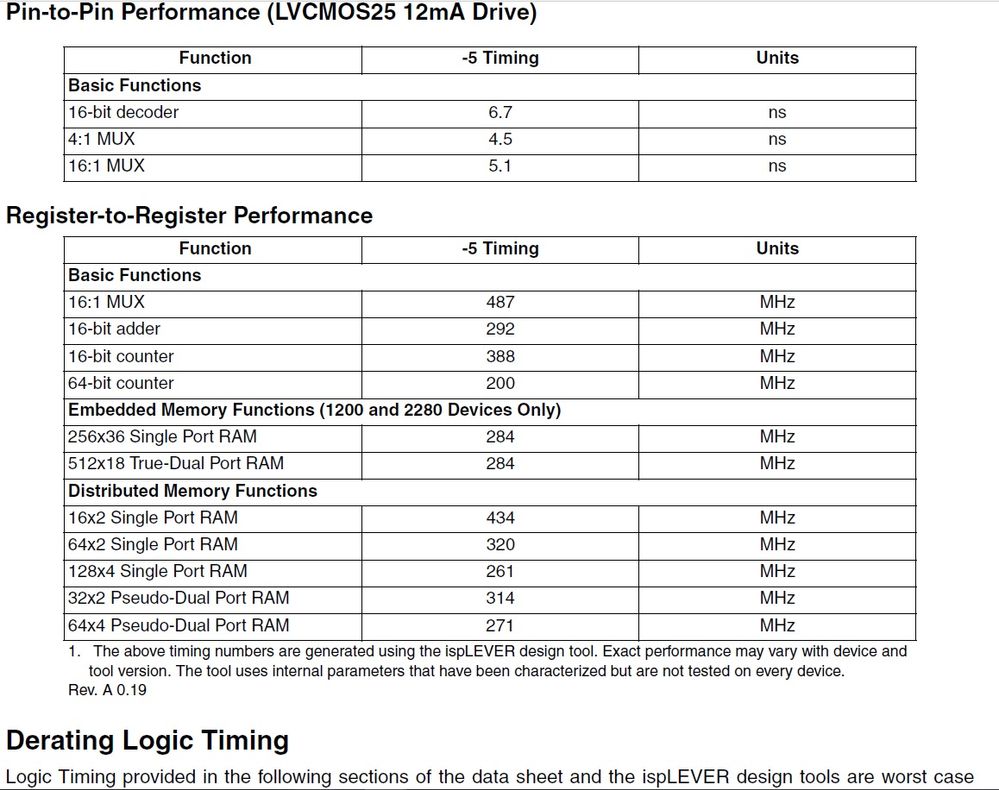

have you considered a hardware solution ?
this chip should be able to adjust your pixel positions 'on the fly'
datasheet attached
but for SPI, you don't need so many pins
this one has enough pins for an SPI solution:
search harder, you may find a similar package with a hardened SPI port.
