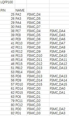

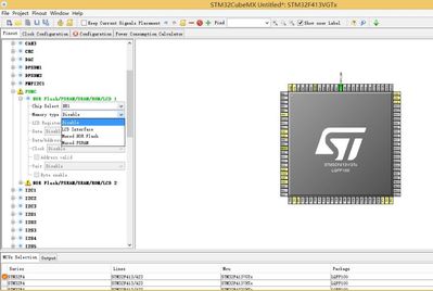

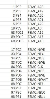

STM32F413VG FSMC Muxed or Non-Muxed?
Posted on February 22, 2017 at 10:52I want to control several FPGA registers by FSMC bus. It's about 30 registers in the FPGA, each register 16bits.MCU package is LQFP100. STM32CubeMX makes the FSMC bus 3 options: LCD ; Muxed NOR Flash; Muxed PSRAM ...
