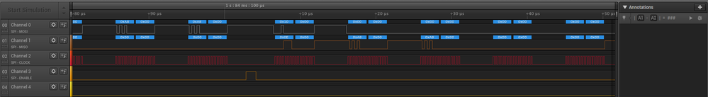

The problem I'm seeing is in the nrf24_check() function. After txbuf is written, and nrf_read_buf is called to read it back, txbuf and rxbuf don't match. Instead of getting 0xA8, 0xA8, 0xA8, 0xA8, 0xA8 back I get 0xA8, 0xA8, 0, 0, 0xA8.I'm trying to check the work with salaea logic, but I'm not sure what I'm looking for, it looks ok to me:2014-10-29 2:08 PM

Well, your logic analyser acquisition was showing 16 bit transfers.

You were right about the 16bit transfers. I fixed that portion with the following code, and now it works:
uint8_t nrf24_read_write(uint8_t data) { while((SPI1->SR & SPI_I2S_FLAG_TXE) == RESET); SPI_SendData8(SPI_PORT, data); while((SPI1->SR & SPI_I2S_FLAG_RXNE) == RESET); return SPI_ReceiveData8(SPI_PORT);}We’re moving the ST Community to a new platform to give you a better and more reliable community experience.
