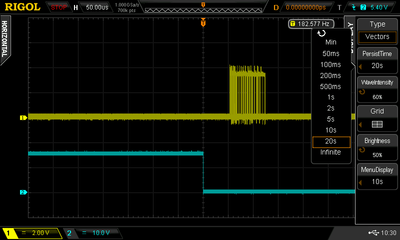

i just tried to see the reaction on some events on a system with H7A3 cpu and was surprised:
EXTI response time was 50 us ! This is a lot for a ARM cpu running at 200MHz - too much, i would say.
ED: wrong timings measured, my error : pins have cer.caps to filter out noise - and also make delays on the signal.
See "solution" , timing measured on pin without any caps -> to INT (setting other pin) is close to expected.
Here the wrong timings :
So i made some tests :
EXTI response time on external signal , setting a port pin in INT , check on a DSO the delay:
on H7A3 , at 200MHz core, I-cache on, -O0 : 50 us !! (never less than 50, sometimes more...because other INT);
on H563 , at 250MHz core, I-cache on, -O2 : 25 us ! (no other INT coming, INT at prio 13 )
on H563 , at 250MHz core, I-cache on, -O2 : 25 us ! (no other INT coming, INT at prio 1 ) ! no diff.
on H563 , at 250MHz core, I-cache on, -O0 : 25 us ! (no other INT coming, INT at prio 1 ) ! no diff.
on H743 , at 200MHz core, I+D cache on, -O2 : 0.5 us ! (constant ) (=> this seems ok, still 100 core clocks needed.)
All on Cube generated init code, on STM32cubeIDE V1.14.1 , standard settings (GCC, -C11 etc, no warnings/errors).
So...any explanation to this ?
Is the "expected" timing from NVIC somewhere given ? I didnt see in ds, rm or PM0253, Cortex®-M7 processor programming manual -- so anybody knows this ? Or is it some kind of secret info... ??
Is there so much and different delay on these cpus or do i something very wrong ? ed.: yes.

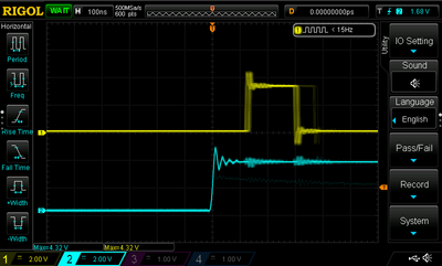

... and this comes out :

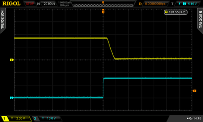

added: about 10us from external signal blue to cpu-pin (yellow), by opto-coupler there:
(with long persistance, to see many INT on one screen) -> some delayed a little, because other INT coming - thats clear.
And HAL_GPIO...set needs about 200ns, i tested separate. Nothing to worry about.
BUT NEVER shorter than about 50us delay, from signal to INT ! (about 10us here from circuit, with opto coupler at input; but still 40us delay from cpu , that i cannot explain.)
ed.: The (almost) 50us delay coming from opto coupler, because the rising (!) pulse is used for INT, and this is much slower than the falling (i checked with scope at first).
So just the 500ns delay remains, but i will check this also, again, with other settings for stack .
But this is no "drama" . :)
Now "correct" test on H563ZIT , at 250M core, I-cache on :
EXTI -> INT time about 120...140ns ; so about 25 core cycles, more than expected - but close.

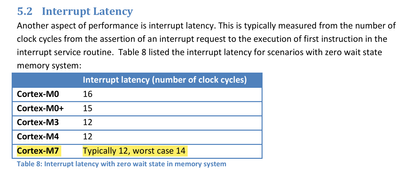

It's quite hidden. 12-14 cycles on the M7.
*Cortex-M for beginners (arm.com)
Be aware there are other things that can increase this time, such as flash wait states, cache misses, probably others.
There is (I believe) additionally some delay between the edge happening and the NVIC bit getting set. Few cycles max I would imagine.
Also, there is a delay between when you write to GPIO->BSRR and the pin actually going high due to the time it takes to send that over the system bus. Less than a few us.
None of that explains the 50 us you're seeing.
