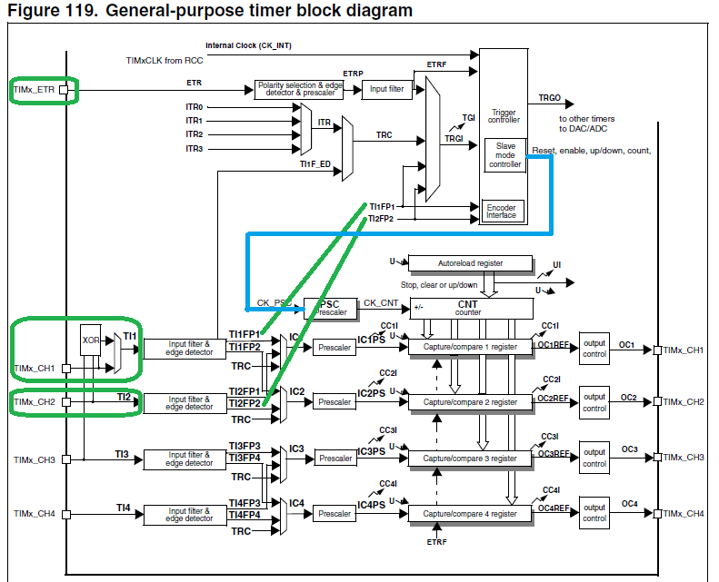

How's CH4 possibly going to route in this scenario?

Oh, i missed that! It should be possible to use channel 3 instead of channel 4, right?

You might be able to do something with the XOR, but that would be the only path I can see.

I achieved to use channel 3 as input to clock signal. The hall sensor for timer 3 should be enabled to do that though. I think it must have something to do with xor gate.

The thread is really about using CH3 as an external clock, clocking the whole timer. You can use CH3 in Input Capture mode without any drama, but not PWM Input mode (duty/period).
Provided the frequency isn't too high, you can catch the CC3 interrupt, and program the values you want into CH4. You likely want to use Toggle mode, and place the edges with advancing values in CCR4. This will however require maximal values for the Period (technically you could have lesser values, but it makes life more difficult perhaps tightening your interrupt deadlines, and requiring MOD operations). What's happening with CH1 and CH2? Motors and Hall Sensors really aren't my thing, so I'll suggest you review/digest the documentation and experiment.We’re moving the ST Community to a new platform to give you a better and more reliable community experience.
