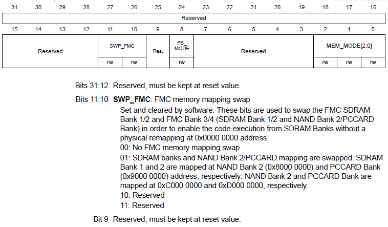

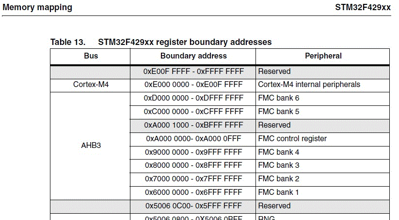

0xC0000000 is the SDRAM in the external memory space (STM324x9I-EVAL), the SDRAM is in a different bank on the STM32F429-DISCO at 0xD0000000
The external memory would need to be initialized before the C run-time start up code would be able to access it.2014-06-26 3:17 PM
2014-06-26 4:41 PM
The Data Sheet and Reference Manual, it's connected to FMC 5 or 6 depending on the board design
