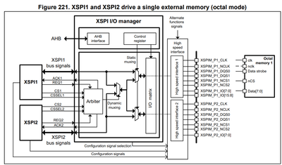

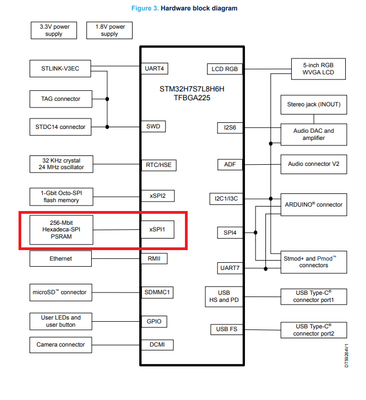

You can use HSPI interface. You can refer to the STM32H7S78-DK board as reference (using APS256XXN-OBR memory):

2024-06-24 7:38 AM - edited 2024-06-24 7:42 AM
2024-06-24 8:42 AM
Thank you!
The problem is that in the package LQFP that I’m using it is not available the HexaSPI only Octa.
2024-06-24 8:57 AM
In that case use it in Octal mode:
2024-06-24 8:58 AM
Perfect, thank you very much!
