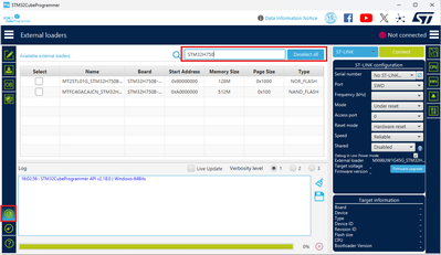

Are you looking for the MTFC4GACAJCN_STM32H750B-DISCO.stdlr and MT25TL01G_STM32H750B-DISCO.stdlr files?
You'll find these files after installing STM32CubeProgrammer under the installation folder ..\Program Files\STMicroelectronics\STM32Cube\STM32CubeProgrammer\bin\ExternalLoader
Also, you can used STM32cubeProgrammer to select these external loader.
