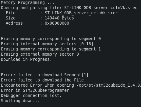

And get a nice long timeout with this result:
I've tried just about everything I can think of for the past 3 days. I'm missing some concept on how the external loader works or ... something.
