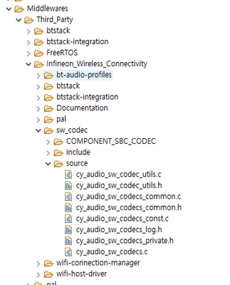

I manually placed the sw_codec folder inside the middleware as follows.
Then I included the folder with library.
but I'm get a error undefined reference to "error"
How to solved?

Not obvious from your description but there are two things to check:
- Include the .h file(s) in the .c file where you are calling these APIs.
- Check again the path to .h files. Check how it was done for other paths like the HAL driver.

2024-09-08 11:57 PM
My problem is infineon package errors, Now I'm solved Thanks.
