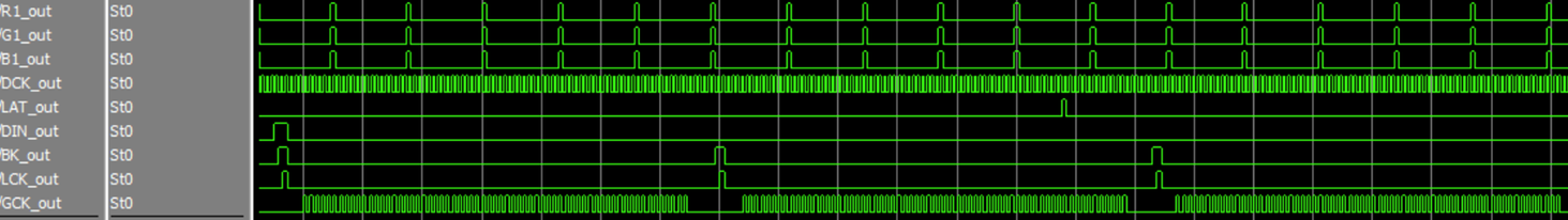

Thanks for your advice, my output pulse should be 5-10MHZ,but because I have another requirements, one is the GPIO output pulse quantity should be controlled ,so I think UART may can't be available. As the below photo shows, the GCK pulse quantity is fixed between two LCK pulse.
