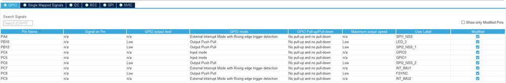

Hi. I have two sensors connected to an STM32f410r8t6, where they send a high signal whenever new data is ready to be read.
Pin connections are as follows:
PC9 (GPIO_EXTI9) -> INT_IMU2
PC7 (GPIO_EXTI7) -> INT_IMU1
I have them setup as follows in the ioc file.
The GPIO and NVIC code is automatically generated.

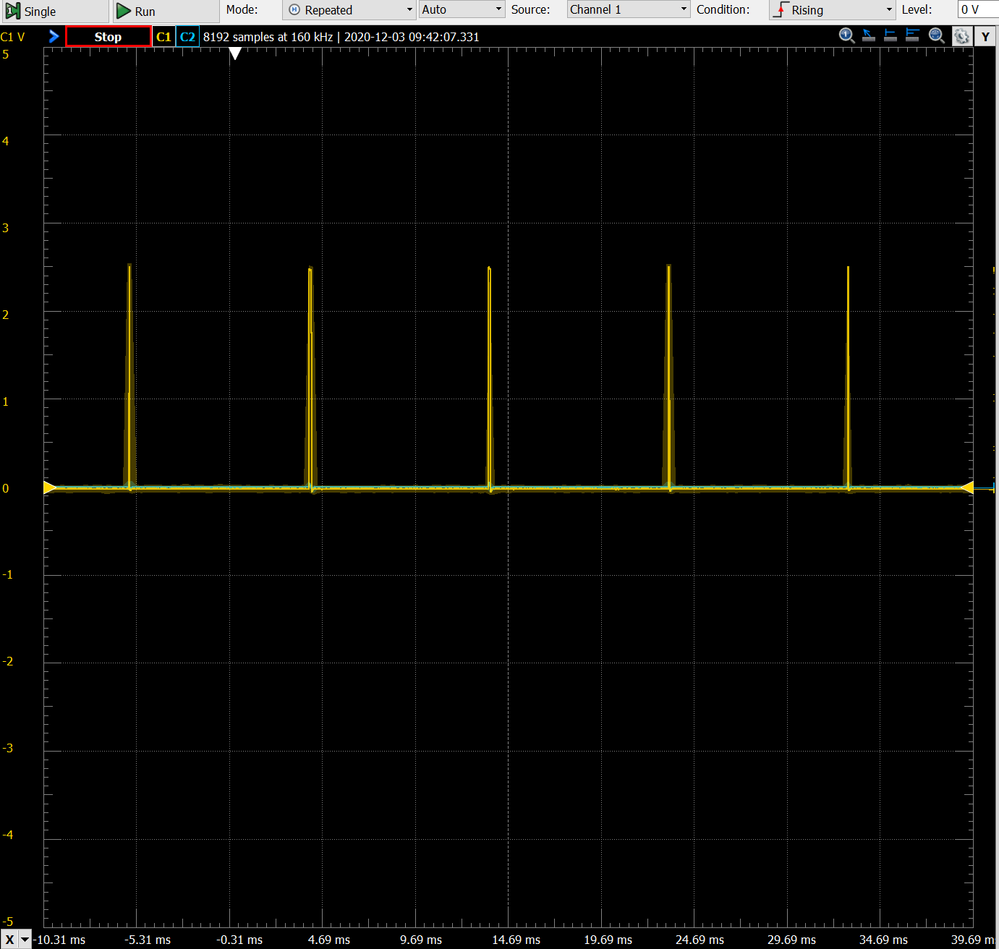

Looking at the line with an oscilloscope I see that the pulses are there:
The high signal is 2.5 V, which should be high enough, as the datasheet for the MCU specifies 0.7*VCC is accepted as V_Hin, and the MCU is supplied with 3.3 V
What stupid thing am I missing?
