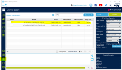

Could you please try to use "MT25TL01G_STM32H745I-DISCO.stldr" under STM32CubeProgrammer path "...\STM32CubeProgrammer\bin\ExternalLoader".
I think it will work because the MT25TL01G_STM32H745I-DISCO" [support memory Size = 128M] for your QSPI memory and MT25QL512A [memory Size = 64MB]. So, the size of your memory is less than the external loader supported by STM32CubeProgrammer.
