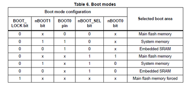

OK. Have finally understood this now thanks to RM0503 table 6 (above).
Since nBOOT_SEL and nBOOT0 are 1 by factory default the device will always boot into main flash regardless of BOOT0 pin. If you want to be able to use BOOT0 to enter bootloader mode then you will have to initially connect a programmer to change the above bits in the user configuration register. Because you probably don't want the device to directly boot into the bootloader every time, then you'll want the second row down which means nBOOT1 = 1 and nBOOT_SEL = 0. Now when you set BOOT0 HIGH on power-up or reset, it will enter bootloader mode.

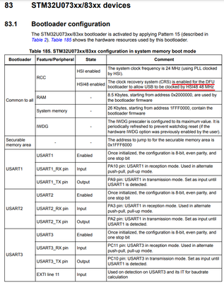

According to AN2606, DFU is using HSI48 clock source, so no need for an external crystal:
It seems that the paragraph you mentioned is generic and it was inherited from older products like STM32F1.

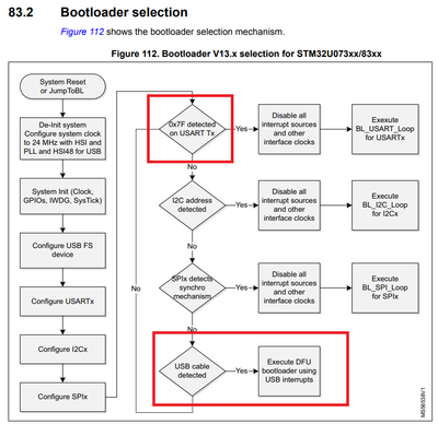

The flowchart in AN2606 shows that USART1 is checked first and USB is last. If there are pullups on the UART RX and TX pins, won't this mean the bootloader will always pick the UART even if there isn't a cable fitted? I'm just thinking ahead to when I sort out why the bootloader isn't running as ideally I'd like to use USB (DFU).
2024-10-31 3:33 AM
According the same application note, that doesn't depend on the HW detection on UART side but depends on if it was receiving a 0x7F:

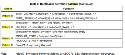

After playing around a bit I have managed to get it into bootloader mode but only after flashing some of the option bits:
This works:
BOOT_LOCK = 0 (unchecked)
BOOT0 pin = HIGH
nBOOT0 = 0 (unchecked)
nBOOT1 = 1 (checked)
nBOOT_SEL = 0 (unchecked)
This is little like the second option of pattern 15 except that I still have to boot up with BOOT0 HIGH but pattern 15 in AN2606 doesn't mention this so I assumed it doesn't care about the state of BOOT0?

in the AN2606, there is nBoot0_SW(bit).
and seems in your case, the nBoot0_SW(bit)= ~nBOOT_SEL.
you can consider the nBoot0_SW as a selection to choose boot0(pin) effective or nboot0(bit) effective.
