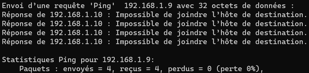

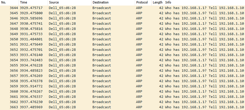

Here is the ethernet traffic between my computer and my dev board when I ping it :
and here the result of the ping command :
We can see that the ping is in wireshark but I get any response from my dev board.
Where? All packets seen on your wireshark screenshot are ARPs from your computer. It does not get any response to these ARPs so it cannot even send ICMP packets (ping).
