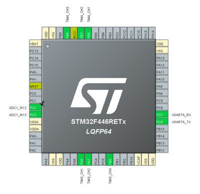

Check for any conflicts between ADC and UART pins?
2024-05-15 7:47 AM
Doesn't look like there could be any conflict. I will scrutinize the PCB itself more
