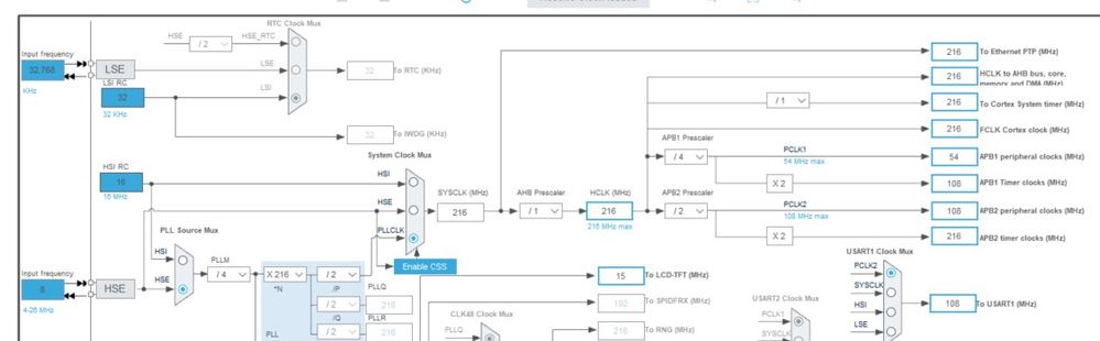

2021-02-07 7:00 PM
void SystemClock_Config(void)
RCC_PeriphCLKInitTypeDef PeriphClkInitStruct = {0};
/** Configure LSE Drive Capability
HAL_PWR_EnableBkUpAccess();
__HAL_RCC_PWR_CLK_ENABLE();
__HAL_PWR_VOLTAGESCALING_CONFIG(PWR_REGULATOR_VOLTAGE_SCALE1);
RCC_OscInitStruct.PLL.PLLM = 4;
RCC_OscInitStruct.PLL.PLLN = 216;
RCC_OscInitStruct.PLL.PLLP = RCC_PLLP_DIV2;
RCC_OscInitStruct.PLL.PLLQ = 2;
Error_Handler();
/** Activate the Over-Drive mode
if (HAL_PWREx_EnableOverDrive() != HAL_OK)
Error_Handler();
RCC_ClkInitStruct.APB1CLKDivider = RCC_HCLK_DIV4;
RCC_ClkInitStruct.APB2CLKDivider = RCC_HCLK_DIV2;
if (HAL_RCC_ClockConfig(&RCC_ClkInitStruct, FLASH_LATENCY_7) != HAL_OK)
Error_Handler();
PeriphClkInitStruct.PeriphClockSelection = RCC_PERIPHCLK_LTDC|RCC_PERIPHCLK_USART1
|RCC_PERIPHCLK_I2C2;
PeriphClkInitStruct.PLLSAI.PLLSAIN = 105;
PeriphClkInitStruct.PLLSAI.PLLSAIR = 7;
PeriphClkInitStruct.PLLSAI.PLLSAIQ = 2;
PeriphClkInitStruct.PLLSAI.PLLSAIP = RCC_PLLSAIP_DIV2;
PeriphClkInitStruct.PLLSAIDivQ = 1;
PeriphClkInitStruct.PLLSAIDivR = RCC_PLLSAIDIVR_2;
PeriphClkInitStruct.Usart1ClockSelection = RCC_USART1CLKSOURCE_PCLK2;
PeriphClkInitStruct.I2c2ClockSelection = RCC_I2C2CLKSOURCE_PCLK1;
if (HAL_RCCEx_PeriphCLKConfig(&PeriphClkInitStruct) != HAL_OK)
Error_Handler();
