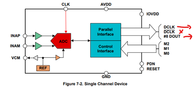

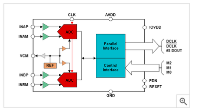

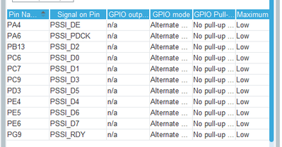

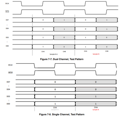

My solution was to go for a newer ADC such as the single channel ADC3908S02
Combining it with an STM32H723ZG (144 pin) using the PSSI (Parallel synchronized slave interface).
Since I cant see any case of DDR, I went for the single channel ADC, even though the dual channel would be beneficial and add more features using the differential clocks.

2025-03-05 5:57 AM
Could I use an older version like an STM32H723ZG ant utilize the PSSI interface with a more modern ADC?
2025-03-06 1:46 AM
2025-03-06 3:01 AM
Dual / multi-channel ADCs would have been to read out sequentially.
But you could operate two ADC in parallel, sharing the control signals and with different data pins.
