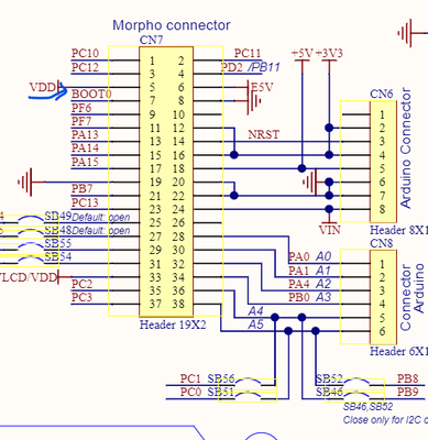

That is how you get into boot loader mode. You can see from the circuit diagram pin 7 on the CN7 connector, the boot pin and i am pulling it high to 3.3V.
