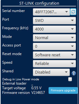

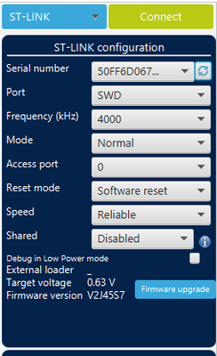

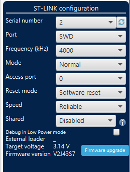

2025-04-27 9:29 AM

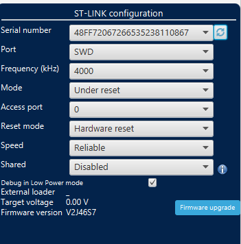

my two genuine stlinks are giving me 0.5 v and my non genuine stlink is giving me 3.14 v , but with my non genuine stlink this mesage apears when charging the code

The "stick" V2 having 3v3 always, because it can give power out on 3v3 pin.
The original V2 needs power from target and shows it...so tried other cable also ?
Because if 3v3 at target, wired to st-link 3v3 "sense" input, but it shows just 0,5V here - no real working wired connection exists.
2025-04-27 10:02 AM
i have tried with 3 diferent cables between stmboard and stlink, and also tries diferent cables between stlink to computer, also whe powering the stmboards the pwr led turns on so indeed theres more than 0.5v coming in
2025-04-27 10:20 AM

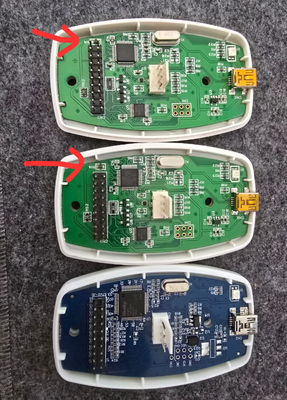

So your sure, to give 3v3 to st-link - but it shows 0,5V ? And same wiring was working before?
Then open one of the "0,5v" candidates and check - maybe you see something "suspect" .
2025-04-27 10:30 AM
yeo im sure,
that resistor is a little bit like to dark, but both give me 10 ohms , the blue one is the Chinese one

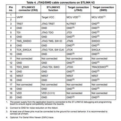

What it shows on CubeProgrammer, if you only wire pin19 to pin 1 or 2 ?
What you connected, when used last time ? 5V ?
2025-04-27 10:55 AM
to pin one 3.3
2025-04-27 11:01 AM

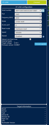

its workingggg
i conected pin 19 to3.3, and 3.3 stlink to a 3,3 v in stbord
